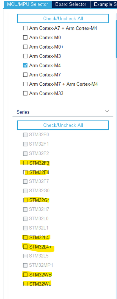

2020-08-24 6:49 AM
Here are all the families with an M4 core. Pretty sure they are all M4F.
Example projects can be found in the corresponding CubeMX repo, which you can view to see if it meets your expectations.
https://github.com/STMicroelectronics/STM32CubeF4/tree/master/Projects
The bottom two series are wireless-enabled and pretty new. I don't have much experience with them.
