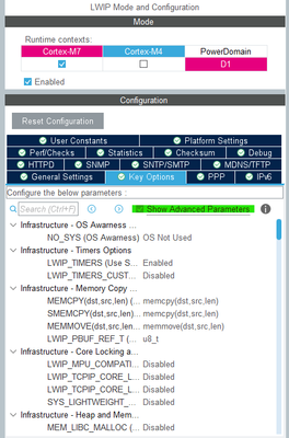

LWIP configurations

Thank you for response back to me. I suspect that might be the cause and I will test it. However, another problem is that it only works with the current specific LwIP configurations. I get an error again when I turn off the Speculation default mode. What could be the reason for this?
Why would it work on the STM32H757I-EVAL Evaluation board even when I turn almost every setting off, but here it only works in a very specific configuration?
Could you please share a technical document that includes the LwIP advanced options settings( @mƎALLEm @Adam BERLINGER )?
