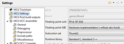

I tried to compile my .c file (the one which calls this lib) with soft floats, via some compiler command line spec. but this does not work. On the command line (GCC) I see -mfpu=fpv4-sp-d16 -mfloat-abi=hard and this is even if I put -mfloat-abi=softfp in the .c file properties / compiler flags. Someone did say this lib does weird float stuff. The doc says nothing about it.

These are my MCU settings

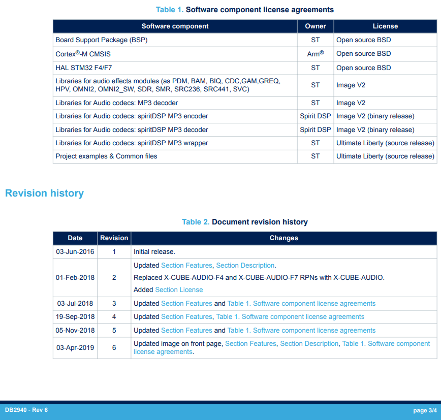

2025-11-29 4:23 AM
It does still seem to be part of the X-CUBE-AUDIO pack:
@mƎALLEm So ST should either remove/replace it, or support it ?
