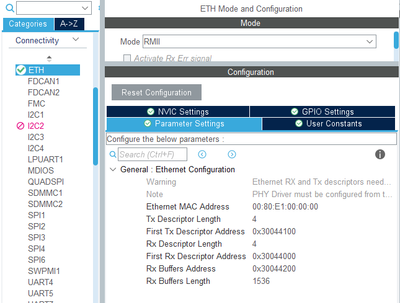

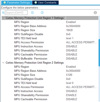

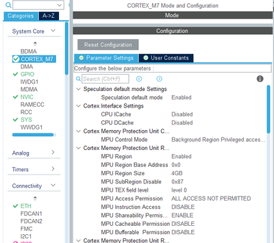

The CubeMX configurations are as follows:
CORTEX_M7 configurations

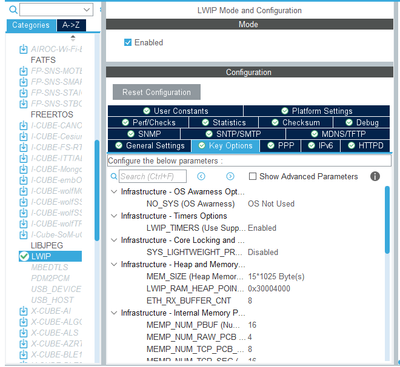

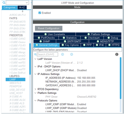

ETH configurations
LWIP configurations
