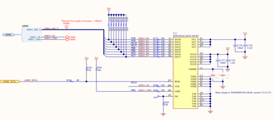

MTFC4GACAJCN is available already on STM32H7 disco board such as STM32H745-DISCO and STM32H750-DISCO. Need to use the BSP drivers provided in the CubeHAL of the boards:
eMMC driver for STM32H745-DISCO:
eMMC driver for STM32H750-DISCO:
And this is the schematic:
Hope that helps.
