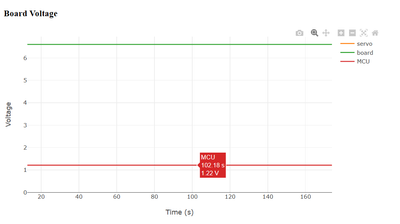

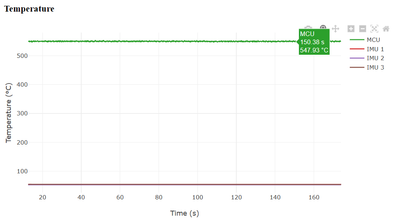

I'm facing similar issue on H743VIT6. Internal temperature is almost 10 times. Even the 3.3V sensing is wrong. I'm using the H743VIT6 rev V.
