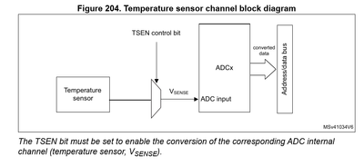

did you set Tsen ?
Hello, thanks for the reply
Yes indeed I set the TSEN with the following :
ADC3_COMMON->CCR |= ADC_CCR_TSEN;
And then I run the calibration
@AScha.3 It is still showing the same output even thought I enabled TSEN
HAL_ADCEx_Calibration_Start(&hadc3,ADC_CALIB_OFFSET_LINEARITY, ADC_SINGLE_ENDED);

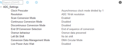

And also here is how I set the ADC3 in Cube
So whats your AVDD and  VREF+  ? check with DMM at the connected pins.
Try ADC settings : overrun data overwritten .

I've changed the ADC settings  to OVERRUN DATA OVERWRITTEN with :
hadc3.Init.Overrun = ADC_OVR_DATA_OVERWRITTEN;
and it didn't fix it
