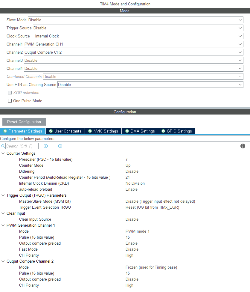

I bought a STM32G431RB Nucleo. I created code for it with the STM32 CubeMX and modiefied the code in the STM32 CubeIDE. I want to access "HAL_TIM_PeriodElapsedCallback" and "HAL_TIM_PWM_PulseFinishedCallback", I read that this is possible by calling "HAL_TIM_Base_Start_IT" for "HAL_TIM_PeriodElapsedCallback" and "HAL_TIM_PWM_Start_IT" for "HAL_TIM_PWM_PulseFinishedCallback". But when I do that, the STM32 seems to crash.
Am I doing something wrong, or is this simply not possible?

More than likely the interrupts are being called so frequently that your main loop cannot progress. You're calling multiple interrupts every 200 timer ticks. That's not a lot of time.
Slow the timer down by a couple of orders of magnitude and try again.

2021-08-31 12:08 PM
Hello TDK,
thanks a lot for your reply, it was correct!
