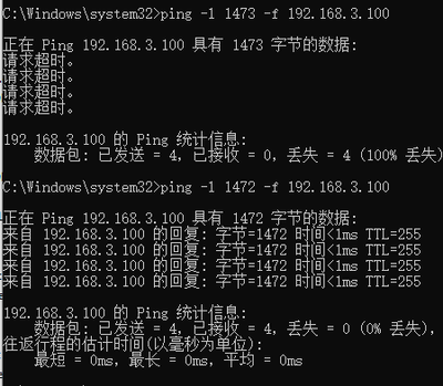

Hello @TTL, and welcome to ST Community!
Have you configured the maximum frame length (Giant Packet Size Limit, GPSL) in the ETH_MACECR register?
It must be greater than your intended frame size (payload + IP + TCP/UDP + Ethernet header + FCS).
