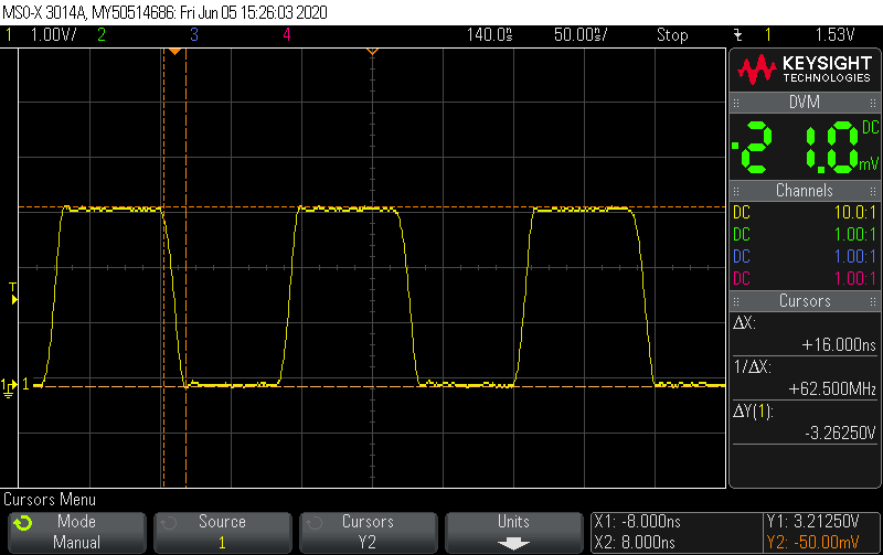

The signals are ok I would say. The lines between STM and USB Jack have the same length (designed with AD19), they are 90 Ohms impedance, the total length is a bit more that 2cm. The signals (DP and DM) look at any point along the line like this:
BTW it's officially upgraded to 3024 200MHz BW.

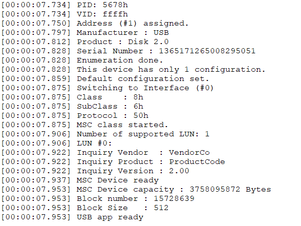

Signals look good. PID 0x5678 and VID 0xffff, that tells a lot. Unfortunately, it's hard to explain to the customer.
Even with tools, this is no joy. I personally would try the widest selection of flash disks as you can get hands on (including whatever family and friends can offer), and if this turns out to be specific to this one particular disk, I would try to talk to the customer.
