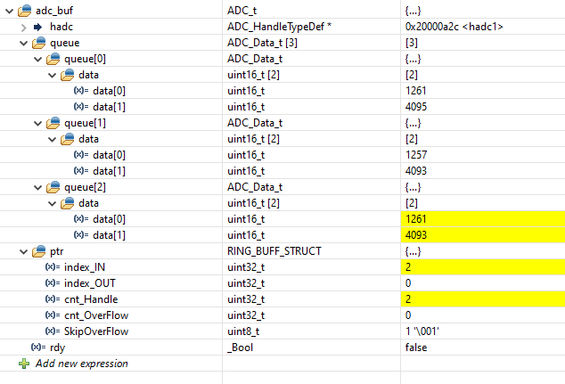

Ok, so it sounds like you want multiple samples of each channel?
You'll need a queue to have the DMA copy to each queue. On each callback, you increment the queue pointer and call HAL_ADC_Start_DMA which will now point to the next queue index. Below is an example code that i just tested.

this is what the debug window will look like. The HAL_ADC_ConvCpltCallback will increment a pointer. If it doesn't rollover (status =0) then i call HAL_ADC_Start_DMA again which is pointing to the next queue index. If it does roll over, it finished it's 3 samples and so I set a flag.
DMA is in Normal mode. Continuous Conversion mode is disabled.
I attached the RingBuffer driver.

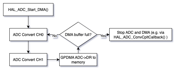

Hi Karl, thanks for the reply! Perhaps something I did not clarify well was that I'm trying to do more than one ADC conversion at a time using DMA peripheral to memory. When I set it up this way, it appears to only perform one conversion then stop. If I disable the linked list configuration but keep continuous conversion enabled, I do have the option to use HAL_ADC_ErrorCallback() to halt the ADC, but that doesn't seem like an ideal solution.

So this reply seems opposite of your original post.
Maybe a flowchart would clear up what you really want to happen?

Hi @Karl Yamashita ! I think I have a solution but to make sure I'm understanding it correctly and not creating issues later, here is a quick flow chart to describe what I was trying to do (I know it is a little simplified with the actual ADC and DMA interactions). In my case, the DMA buffer can handle many conversions and I only want it to stop once the buffer is full (as described by the size in the HAL_ADC_Start_DMA() call).
