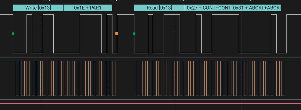

from the example code that i made i try to give the bos1921 a adres, after that i try to read from the Register 0x02 and expect a value of 0x046A in return. but everytime it looks like it's the value from register 0x1E, that is the CHIP_ID. Even trying to read other registers i get the same result.
Any idea what I'm doing wrong trying to read?

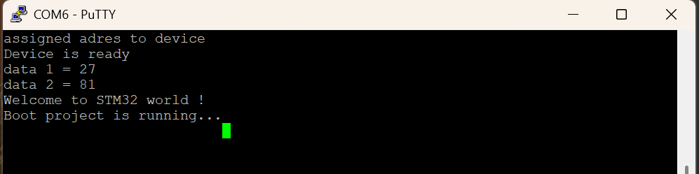

Screenshot of the prints that it made: 

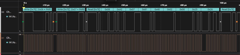

Screenshots from my logic analyzer:
Assigning adress:
trying to read:
