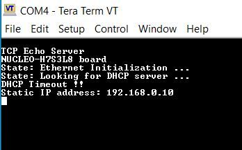

I started a DHCP server using Tftpd32 software, but the MCU didn’t get a DHCP IP and showed a static IP (192.168.0.10) instead.

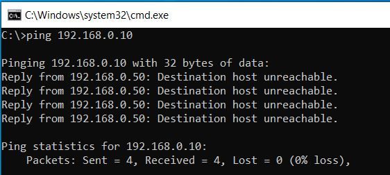

I tried pinging the MCU’s static IP from my laptop using a straight Ethernet cable, but it failed.
I tested with both crossover and straight Ethernet cables and used a Wi-Fi modem/router as another DHCP server, but the result was the same.

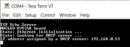

MCU Comm3 serial responseMCU Comm3 serial response
Ping request from Laptop to the MCUPing request from Laptop to the MCU

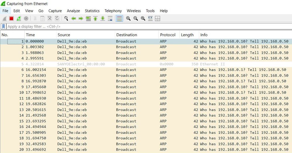

Wireshark packet while sending echo command from Laptop to the MCUWireshark packet while sending echo command from Laptop to the MCU

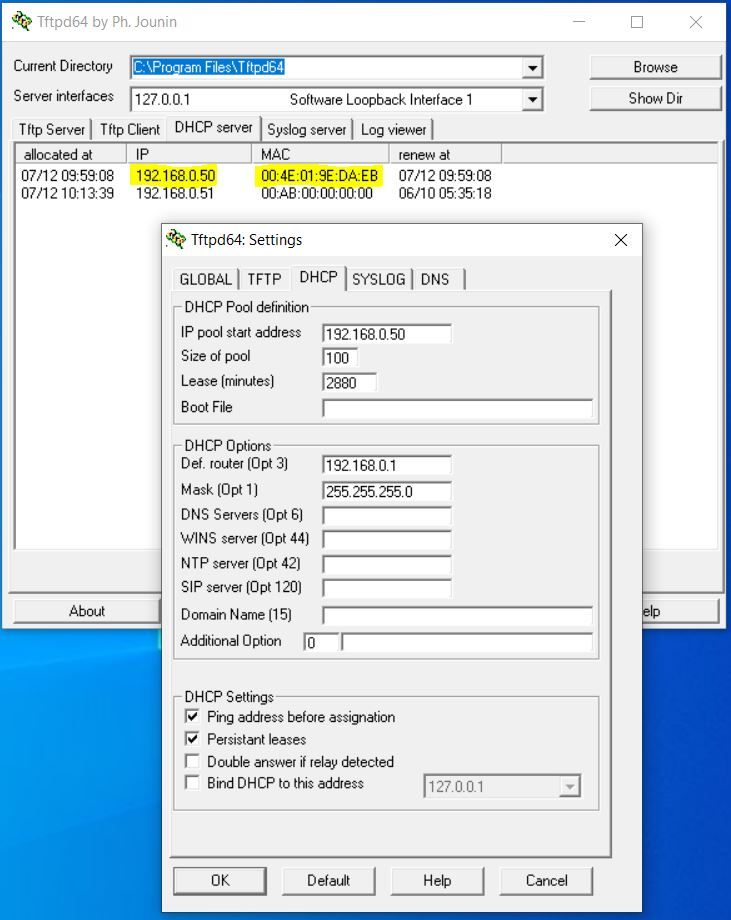

DHCP server - PC utility TFTPD32DHCP server - PC utility TFTPD32

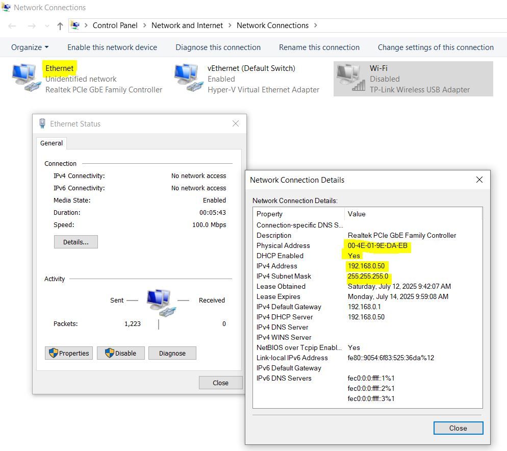

Laptop IP Address configurationLaptop IP Address configuration

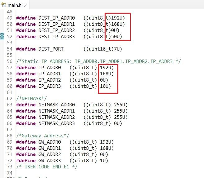

Main_h fileMain_h file

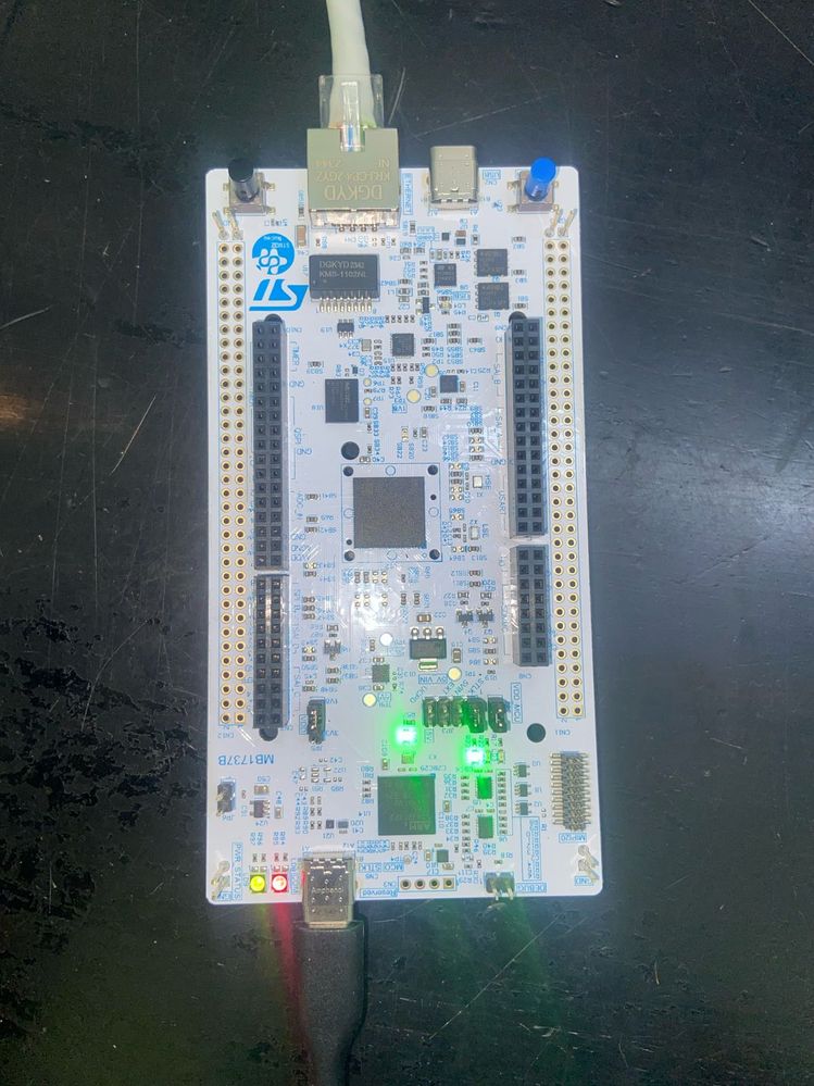

MCU Board ImageMCU Board Image

It looks like your board does not respond to ARP at all. Check if it receives any eth packet (set breakpoint in low_level_input).

Hello @Sajidaap,
Please try changing the JP5 jumper position to 3V3; this should resolve the issue.

It's worked when I changed the jumper JP5 to 3V3 while the XSPI2_HSLV bit is enabled.
@STackPointer64, Thanks for the solution.

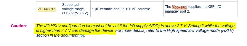

Would you please help me to understand the part highlighted below? I have enabled the XSPI2_HSLV bit while the jumper JP5 is connected to 3V3.
Also, the Jumper setting is not mentioned in the Readme file!
Table 4. Power supply connectionTable 4. Power supply connection

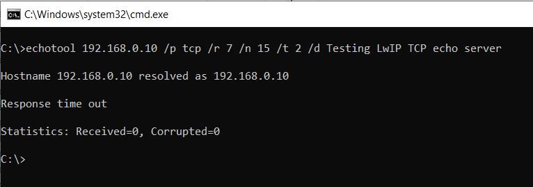

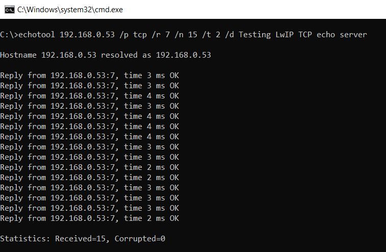

echotoolechotool
DHCPDHCP
Yes, my recommendation was to set the jumper to 3V3 while the XSPI2-HSLV option is enabled. I’m glad to hear that this resolved your issue. Regarding your question, the highlighted section refers to the VDDIO_HSLV option byte, which must not be activated when the device operates above 2.7V, as this could potentially damage your device.
