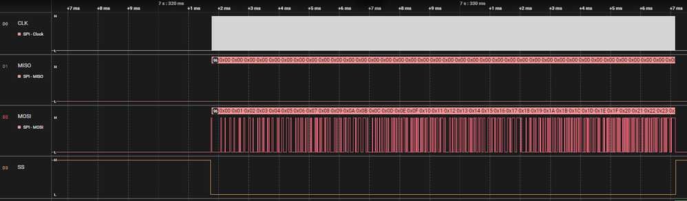

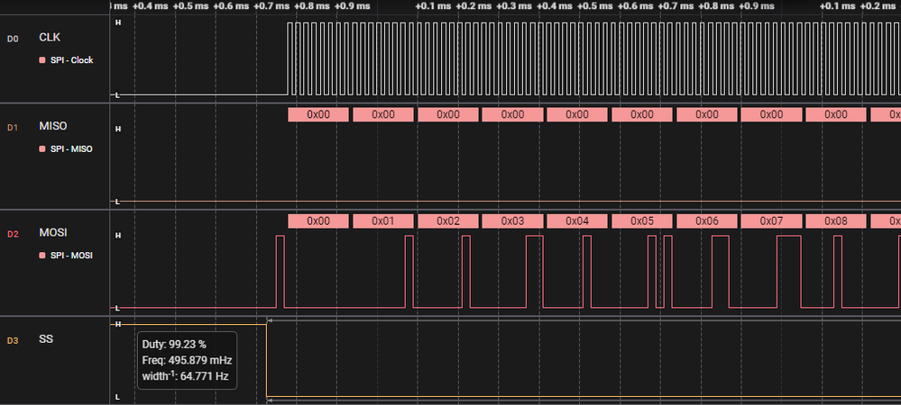

Hello everyone,

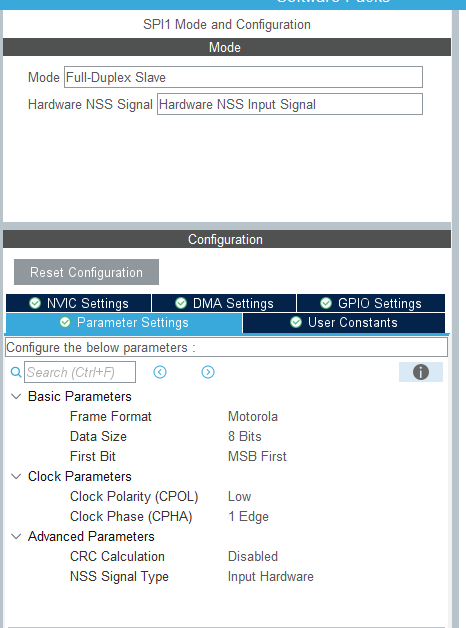

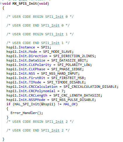

I have setup my stm32 to use interrupts and have enabled them to work on spi1 and all 4 i2c ports. The relevance of the i2c ports is that they run continuously and may call the interrupt service routine while the spi one is being called. To isolate this possibility I have disabled interrupts for the spi callback.
At the start of the main of the stm32 slave I call
HAL_SPI_TransmitReceive_IT(&hspi1, tx_buff, rx_buff, size);

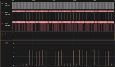

From a Raspberry Pi I am sending from 0 to 95 in a single transaction while simultaneously reading the bus. The stm32 receives the data as expected (which I have checked in debug mode) but sends nothing in response. I have checked the miso port with a logic analyzer and you can see in the photos.

2024-11-22 10:17 AM - edited 2024-11-22 10:30 AM

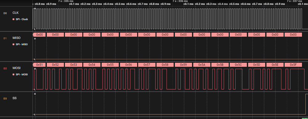

With this code as the whole main I still got no response. It prints "Writing" twice before the master even sends anything but I don't see anything on the logic analyzer. alt_main() is called just before the while(1) in the normal main()

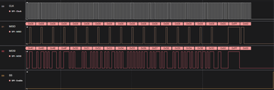

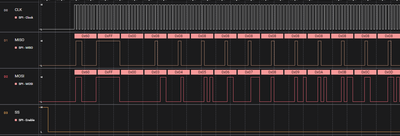

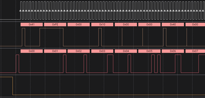

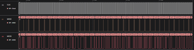

2024-11-25 3:32 AM - edited 2024-11-25 3:36 AM

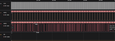

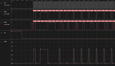

Thanks for your suggestions. As a GPIO output the MISO pin works perfectly. I did 3 tests, the first two were at 50kHz and gave wrong results but indicate a bit offset which accumulates and destroys the whole miso packet. In bold are the preamble to help check for offsets: 0x60=96 is the packet length, then 0xFF and 0x00 are there to make it obvious. I am not completely sure but the registers look good to me.
1st test:
2nd test: Works until 5th byte, then appears to be shifted right by one bit (kind of) based on what the stm32 received which is not the same as seen on the logic analyzer
3rd test: CLK is 500kHz and it works perfectly except when it doesn't. There are a few packets that give random data but the consequent packets are fine. Slave and master receive data as expected too.

This is quite likely a hardware problem, the slave "sees" multiple SCLK edges where master generated one.
Use very short interconnections. Avoid "flying leads", crappy connectors. Use dedicated ground=return to each signal plus ground to power supply. Keep the SCLK return together with the signal (preferrably twisted). Reduce SCLK's slew rate on master, if possible.
