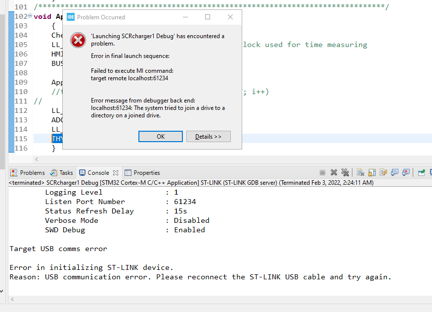

2022-02-02 2:59 PM
I have the same problem with STM32CubeIDE 1.8.0
