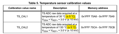

I am working on the STM32G431RB Nucleo board, specifically on the internal temperature sensor. I am facing issues in getting accurate readings.
For your reference, I have attached:
My code implementation
An Excel sheet comparing temperature readings with respect to a thermal chamber
The sensor readings are not matching the expected values. Could you please guide me on the correct way to use this sensor and help identify any corrections required in my implementation?

Do you perform ADC calibration as the first thing before performing the first conversion?
Other than that, here is a checklist.
2025-09-18 5:08 AM
There must be a call to calibrate it before using. CubeMX adds it for most families but it looks like it's missing here.
if (HAL_ADCEx_Calibration_Start(&hadc1, ADC_SINGLE_ENDED) != HAL_OK)
2025-09-18 5:23 AM
ok i will try this one and share the results.

I would say your expectations are a bit high.
2025-09-19 2:13 AM
So you’re saying there is an error of ±5 °C, right?
2025-09-19 3:26 AM
I'm saying there is a lot of room for error and that you should not expect the internal temperature sensor to be a precision device.
Also, the datasheet says TS_CAL2 is acquired at 130°C, but your code uses 110.
