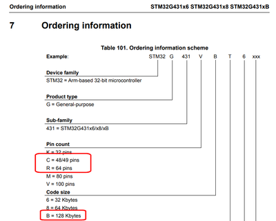

@MM..1 wrote:Work this X-Cube-EEPROM realy on CB or only on RB ???
The only difference between Cx and Rx is the number of package pins:
so that shouldn't have any effect on the internal operation

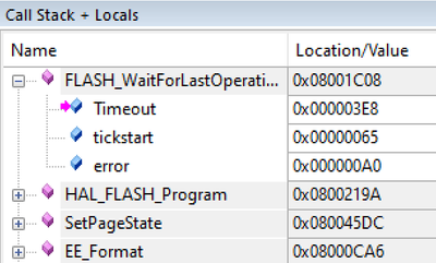

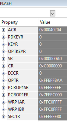

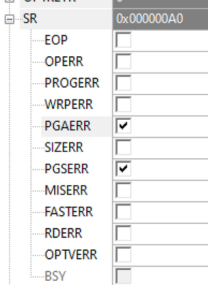

2025-04-03 10:04 AM - edited 2025-04-03 10:15 AM
HAL_StatusTypeDef FLASH_WaitForLastOperation(uint32_t Timeout)
/* Wait for the FLASH operation to complete by polling on BUSY flag to be reset.
Even if the FLASH operation fails, the BUSY flag will be reset and an error
flag will be set */
uint32_t tickstart = HAL_GetTick();
uint32_t error;
while (__HAL_FLASH_GET_FLAG(FLASH_FLAG_BSY))
if ((HAL_GetTick() - tickstart) > Timeout)
return HAL_TIMEOUT;
/* Check FLASH operation error flags */
error = (FLASH->SR & FLASH_FLAG_SR_ERRORS);
if (error != 0u)
/* Save the error code */
pFlash.ErrorCode |= error;
/* Clear error programming flags */
__HAL_FLASH_CLEAR_FLAG(error);
return HAL_ERROR;here is error and flag set is
case STATE_PAGE_ACTIVE:
/* Set new Page status to STATE_PAGE_ACTIVE status */
if (FI_WriteDoubleWord(header2, EE_PAGESTAT_ACTIVE) != HAL_OK)
return EE_WRITE_ERROR;
ubCurrentActivePage = Page;
break;
