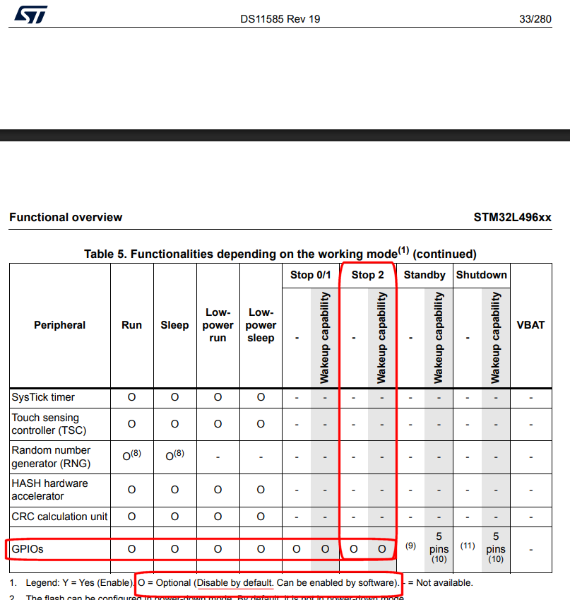

Have you enabled the pin in STOP2 ?
https://www.st.com/resource/en/datasheet/stm32l496ag.pdf#page=34
via: https://www.st.com/en/microcontrollers-microprocessors/stm32l496ag.html#documentation
2025-04-04 1:43 AM
yes i did.

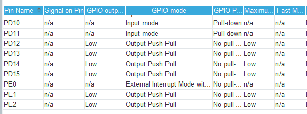

/*Configure GPIO pin : PE0 */
GPIO_InitStruct.Pin = GPIO_PIN_0;
GPIO_InitStruct.Mode = GPIO_MODE_IT_RISING;
HAL_GPIO_Init(GPIOE, &GPIO_InitStruct);

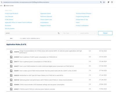

@Chintu wrote:if you have any sample code wake-up from stop2mode please provide.
Have you looked at the samples available via CubeIDE?
ie, the examples in the STM32CubeL4 pack ?
Try a search for "power" on the Product Page 'Documentation' Tab:

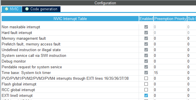

2025-04-04 2:47 AM
stm32l496zgt6
STM32CubeIDE
development board
Not coming out from stop2mode though external interrupt GPIO PE0 interrupt generating before entering's stop2mode but not in stop2mode what is the process to follow the wake up the controller stop2mode to normal mode.
