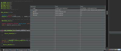

i am trying to implement Openamp to in a project with touchgfx. In the beginning i started with openamp and it worked. M7 was the master, M4 the slave and i had a working implementation. It turned out that encoders etc are better handleled on the M7 near touchgfx so alot of the project was rewritten. What i added is 8 AD converter with 200kHz sampling frequency which is handled by DMA. 32kB of the D2 Ram where reserved and protected by the MPU. Since i want to calculate a fft, the ad samples get copied to the dtcmram which is i also added in the linker file. Since the M4 now only handles the network communication, it seemed better suited as the master for openamp. It can initiallice OPENAMP while touchgfx is busy setting up everything else and then starts a task to join as slave. I couldnt get it to work. I always got hard faults. I changed it back to the same configuration as it was before but i cant get it to work. There is a hardf fault every time the M4 try to init th MX_OPENAMP_Init(). It works its way up to metal_bus_register(struct metal_bus *bus) and then throws the error. Everything seems to me like the M4 has no access to the shared memory. The Ressource Table is at 0x38000000 (1kB) and shared memory starts at 0x38000400 (63kB). This is the beginning of D3 RAM. I read that the M4 has no access to the D3 RAM so i changed it to D2 0x30008000 and 0x30008400 (first 32kB of D2 are for DMA Buffer). This did not work for me either. Can aybody help me here?

M4 main
int32_t status = 0;
memset((void *)SHMEM_ADDR, 0, SHMEM_SIZE);
/* Initialize the mailbox use notify the other core on new message */
MAILBOX_Init();
/* Initialize OpenAmp and libmetal libraries */
if (MX_OPENAMP_Init(RPMSG_REMOTE, NULL)!= HAL_OK)
Error_Handler();
/* Create an endpoint for rmpsg communication */
status = OPENAMP_create_endpoint(&rp_endpoint, RPMSG_SERVICE_NAME, RPMSG_ADDR_ANY, rpmsg_recv_callback, NULL);

What I found is that it starts with this function, MX_OPENAMP_Init(...). The last function call is metal_bus_register(...), which gets a struct object named metal_generic_bus. The objects address can be read in the main and is valid, but the name is not accessible and has a very strange memory adress. Trying to access the name object leads to a hard fault. Shown below is the piece of code that cause the hard fault while trying to access the name varible.
int metal_bus_register(struct metal_bus *bus)
if (!bus || !bus->name || !strlen(bus->name))
return -EINVAL;
Here is a picture of the main, where i try to access the struct, and on the name there is no access.
I really do not understand why this is happening.
If you need further informaitions about the files or the struct please let me know. Nothing has been changed in the openamp files.
Any help is highly appreciated
Thanks
