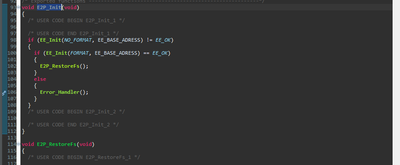

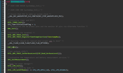

When running the application, the firmware consistently fails during EEPROM emulation initialization. The execution enters E2P_Init() and stops very early inside the function.
Observed behavior:
  • After that, the application ends up in Error_Handler()

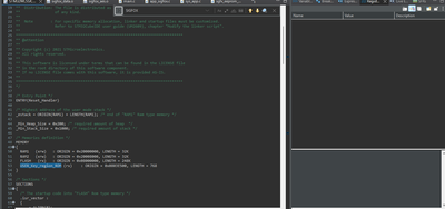

EEPROM configuration:
In sgfx_eeprom_if.h, EEPROM emulation is configured as follows:
  • Flash page size: 0x800 (2 KB)
  • EEPROM bank size: 2 pages (4 KB)
  • EEPROM base address set to the last two Flash pages:
    EE_BASE_ADRESS = 0x0803F000
(256 KB Flash device, address range 0x08000000 – 0x0803FFFF)
I already performed:
  • Full chip erase
  • Clean rebuild
  • Debugging on Cortex-M4
  • Verification that EEPROM does not overlap with application code
Despite this, E2P_Init() still fails very early.
