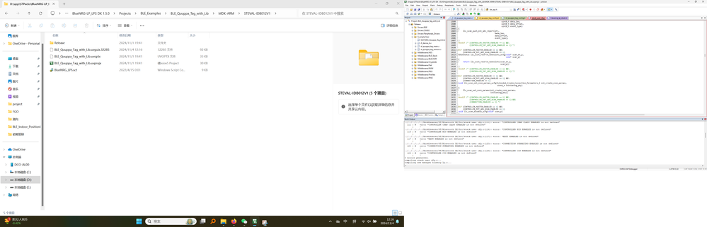

We have purchased the STEVAL-IDB012V1 evaluation kit. On ST's official website, we found a software package for QUUPPA tag emulation using BlueNRG-LP/LPS (en.STSW-QUUPPA-ETAG.zip). After downloading, we extracted it into the BlueNRG SDK (STSW-BNRGLP-DK). However, when I tried to compile the project using Keil, I encountered errors. The error details are shown in Attachment 1.
The version of Keil I am using is 5.40, and the compiler version is 6.09.

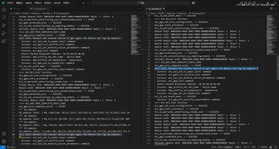

I used two custom STM32WB09 development boards to test the `BLE_Beacon_AoA_Tag` and `BLE_Beacon_Scanner_AoA_Locator` examples from the SDK.
I was able to receive IQ data via the serial port, but there is a serious issue:
After receiving a small number of IQ samples, the following error is triggered:
```c
case HCI_LE_PERIODIC_ADVERTISING_SYNC_LOST_SUBEVT_CODE:
APP_DBG_MSG("Sync lost! Restart the scanner device to get again the Beacon AoA Tag IQ samples !\r\n");
//device_state = START_SCANNING; //TBR???
I noticed that you might have intended to restart the scanning process, but the code is commented out, and the "TBR???" comment is left in the official SDK release. Is this a hardware design issue causing the connection to drop?
