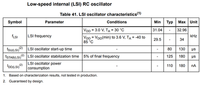

Why does the LSI have +-50% tolerance?
The LSI here does not have +/- 50% tolerance. Perhaps create a new post if you have additional questions.
To address the general question: Why is the LSI not exact? Because fabrication tolerances, specifically on oscillator circuits like this, contribute to the tolerance.

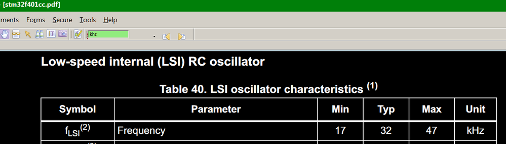

mrx23
Associate III
Well this one has
How come the tolerance is so much bigger on this one?
Andrei Chichak
Lead II
LSI is intended to run the independent watchdog, not in lockstep with the external crystal, but independent of the external crystals. The frequency is crappy and varies with temperature, but you don't need external components.
Some figure that it is a 32767 Hz source. No, it's 30kHz, or 40kHz, or 17-47kHz, depending on how the die was laid out on a day, the temperature, and phase of the moon. Don't use it where you expect a reliable, predictable frequency. If you use it as a IWDG, don't set your tolerances too tight or you will be sad.
