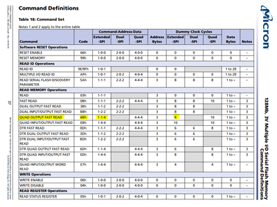

Hi @G_Anastasopoulos ,
Could you please check the Dummy cycle. I noted in the driver code "qspi_flash.c" specifically in the the function "CSP_QSPI_EnableMemoryMappedMode(void)", the command-address-data is set to 1-1-4 which is for extended SPI, and dummy cycle set for 10 in "qspi_flash.h" , which is intended for Quad SPI mode as mentioned in the memory datasheet. However, according to the datasheet, dummy cycle configuration for extended SPI should be 8. Therefore, I suggest changing the "DUMMY_CLOCK_CYCLES_READ_QUAD" to "DUMMY_CLOCK_CYCLES_READ" = 8 in the "qspi_flash.h".
Thank you.

Tentative External Loader build for OCTOSPI2 / U599 / MT25QL128
https://github.com/cturvey/stm32extldr/blob/main/u5_mt25q128/README.md
