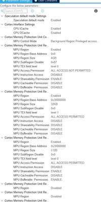

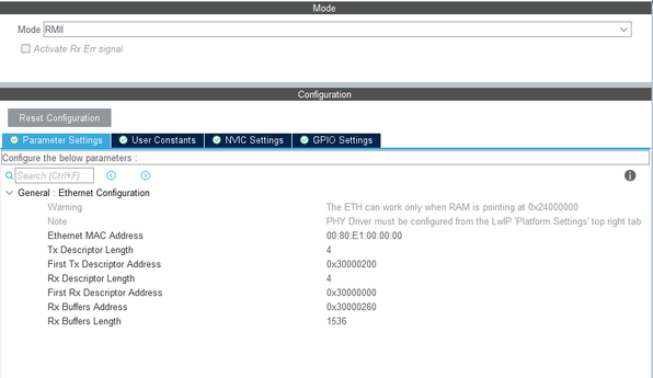

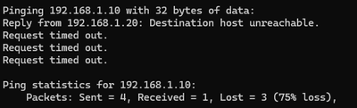

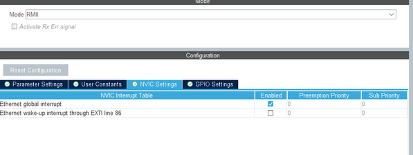

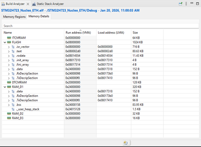

2026-01-19 10:06 PM
I have downloaded the ZIP file from the link you provided:
Link: https://github.com/stm32-hotspot/STM32H7-LwIP-Examples
I also installed STM32CubeIDE version 1.9.0 and flashed the firmware onto the board. After flashing the code, I tested whether the assigned IP address responds to ping requests; however, the ping test still fails.

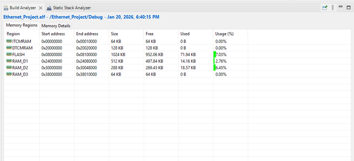

While flashing the project the memory locations are

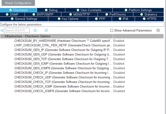

The CubeMX parameter settings are,

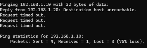

The ping test result is,
For your reference, I have attached the project folder used for this test.

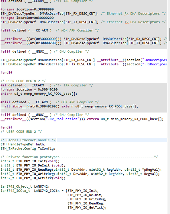

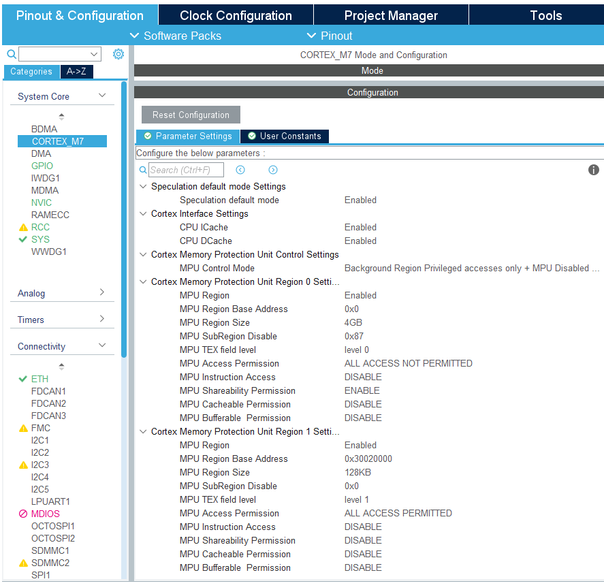

2026-01-19 10:21 PM
Your MPU configuration is incorrect, and the Rx_PoolSection must not be placed in SRAM2.
For STM32H7 Ethernet + LwIP, RX buffers must be located in D1 RAM (address range 0x24000000–0x30007FFF).
1) Update the linker script:
2) Configure the MPU as described in the following ST article:
https://community.st.com/t5/stm32-mcus/how-to-create-a-project-for-stm32h7-with-ethernet-and-lwip-stack/ta-p/49308
~Aj
2026-01-20 4:36 AM
If you want to try an alternative to LWIP, go to https://mongoose.ws/wizard/#/output?board=h723&ide=CubeIDE&rtos=FreeRTOS&file=README.md , choose the destination directory in the settings tab, , click generate button - then load the saved project in your Cube IDE.
That uses Mongoose TCP/IP stack instead of LWIP, and gives you a ready-to-use Web UI, MQTT, and remote firmware updates.
Regardless of the TCP/IP stack you use, the trick with STM32H7 is that Ethernet DMA controller can access only certain memory regions. The driver code defines DMA buffers with a special flag, __attribute__ section ..., which places those buffers in a specific ELF section, and your linker script must place that section in the region accessible by the Ethernet DMA controller. That what ajmw_' s suggestion is about.
The H723 has the following regions;
MEMORY
ITCMRAM (xrw) : ORIGIN = 0x00000000, LENGTH = 64K
DTCMRAM (xrw) : ORIGIN = 0x20000000, LENGTH = 128K
FLASH (rx) : ORIGIN = 0x08000000, LENGTH = 1024K
RAM_D1 (xrw) : ORIGIN = 0x24000000, LENGTH = 320K
RAM_D2 (xrw) : ORIGIN = 0x30000000, LENGTH = 32K
RAM_D3 (xrw) : ORIGIN = 0x38000000, LENGTH = 16K
You can get the same info from the https://www.st.com/resource/en/datasheet/stm32h723zg.pdf datasheet, section 3.3.2. Ethernet controller is on D2 domain, thus place DMA buffers in any of the D2 domain region, for example ITCMRAM, or RAM_D1 or RAM_D2

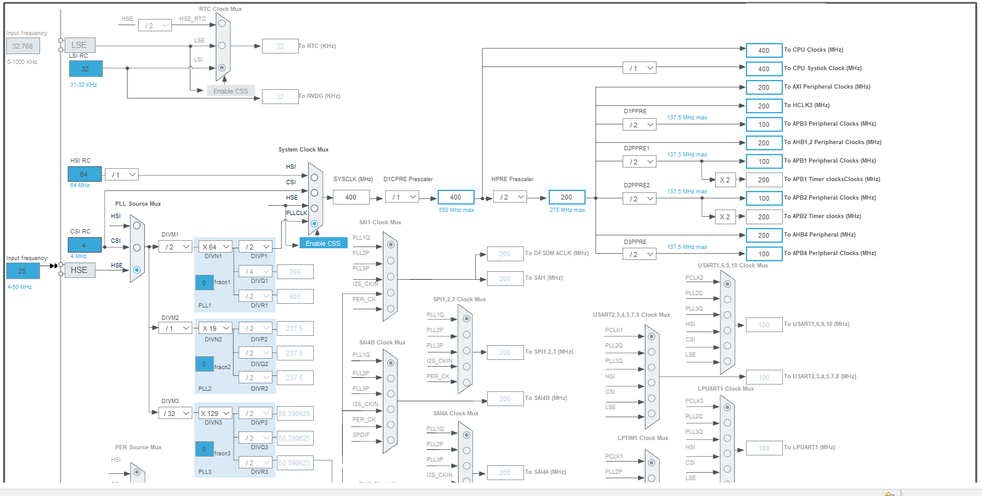

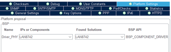

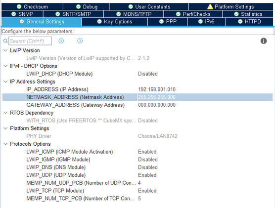

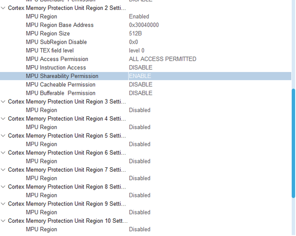

2026-01-20 4:47 AM - edited 2026-01-20 5:08 AM

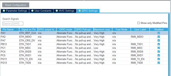

Board: NUCLEO-H723ZG
Configure clock tree:
ETH_MDC speed couldn't be changed
Finally, I am able to receive a response when performing the ping test, as shown below.
However, after following all of your instructions earlier, I was initially unable to ping the IP address. Could you please help clarify why the ping was not successful at that stage?
2026-01-20 5:12 AM - last edited on 2026-01-20 5:14 AM by mƎALLEm

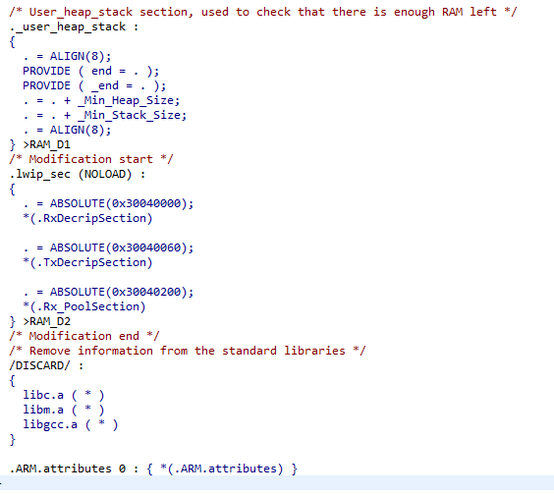

/* Modification start */
.lwip_sec (NOLOAD) :
. = ALIGN(32);
*(.RxDecripSection)
. = ALIGN(32);
*(.TxDecripSection)
. = ALIGN(32);
*(.Rx_PoolSection)
} >RAM_D2
/* Modification end */

Kindly review it.

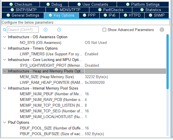

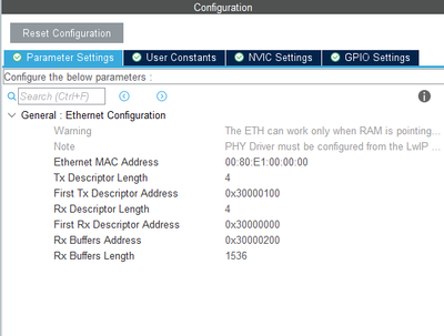

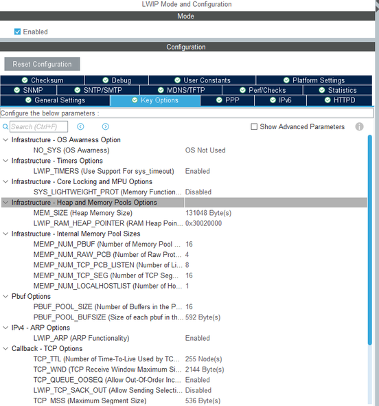

2026-01-20 5:26 AM
Refer to the following article carefully instead of directly copy-pasting the configuration:
Your current configuration targets STM32H74x/H75x devices, but you are using STM32H723ZGT6, which has only 32 KB of SRAM2.Therefore, the RX buffers must be placed in AXI SRAM at 0x24000000, not in SRAM2. Also, the lwip_sec linker section is incorrect. Please refer to my previous reply for the correct linker script configuration.
1) " LWIP_RAM_HEAP_POINTER (RAM Heap Pointer) should be in SRAM2 @0x30000200"
2) MEM_SIZE (Heap Memory Size) = 32232
~ AJ

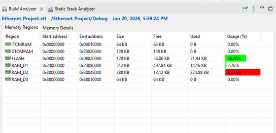

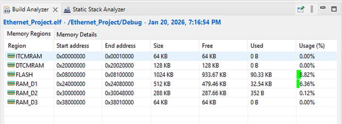

2026-01-20 5:53 AM
The shared article contains the memory allocation for the STM32H74x/H75x devices only, Whenever I'm using the STM32H723ZGT6, I have some confusions.
I have done the configuration/code & allocation with the help of the article: https://community.st.com/t5/stm32-mcus/how-to-create-a-project-for-stm32h7-with-ethernet-and-lwip-stack/ta-p/49308.
Now with your guidance, I've changed the LWIP_RAM_HEAP_POINTER & MEM_SIZE (Heap Memory Size) respectively.
and also updated the Flash.ld with your guidance. Review it.
. = ABSOLUTE(0x30000000);
*(.RxDecripSection)
. = ABSOLUTE(0x30000100);
*(.TxDecripSection)
} >RAM_D2 AT> FLASH
