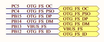

Thanks Clive. The schematic seems to show the user USB is FS, and not HS. Also I have found instructions on how to do that in older materials, just not sure if the new version of the board, the DISCO1, has any changes in that aspect. Here is the schematic for the USB.
2018-04-02 7:45 PM
It uses PB14/PB15 OTG_HS_DM/OTG_HS_DP, which via the internal PHY works in FS mode
Only works on USB PA11/PA12 OTG_FS_DM/OTG_FS_DP
