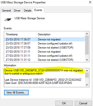

2018-03-27 1:07 AM
I have an another board stm32f4-discovery, I ported the above code to it and this is what I get

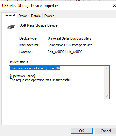

2018-03-27 4:41 AM
On further looking for information this is what I got

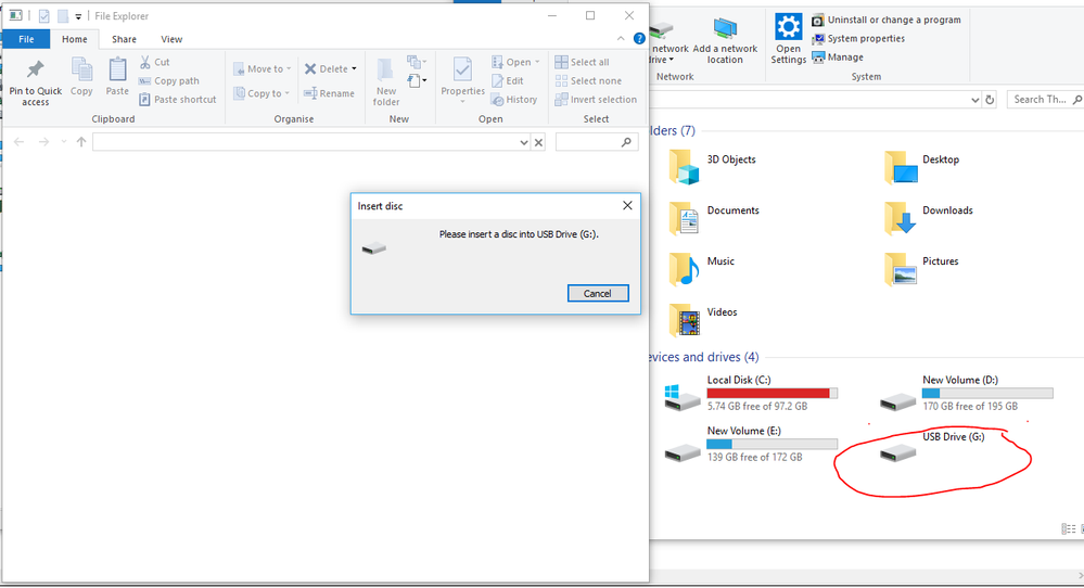

2018-03-29 11:29 PM
Update :
After plugin the usb, and I am powering through USB VBUS I get a popup and I can see the removable drive in file explorer but it's not able to detect or access it
Any suggestions or help?

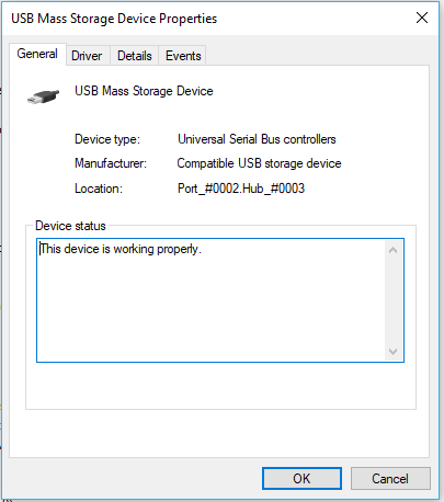

2018-03-30 3:00 AM
Update :
I am able to copy and delete files but can't write something.
Any suggestions?

2018-04-03 11:26 PM
Thanks for your reply.
I was able to resolve it eventually.
SD card was detected I used to get the popup and it used to appear in removable device, but the PC wasn't able to access the SD card.
After completing sd fatfs and usb initialisation.
I again called sd_init and it worked
