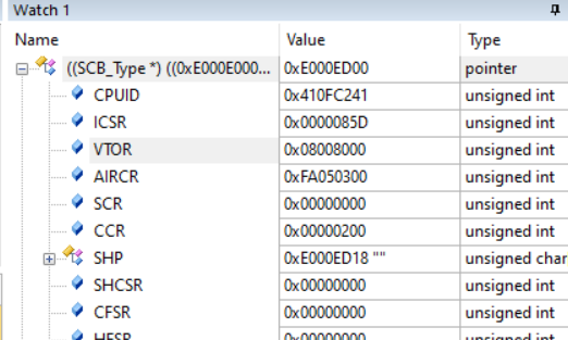

2020-09-09 5:26 PM
I have checked the VTOR using debug tool. It seems ok.
