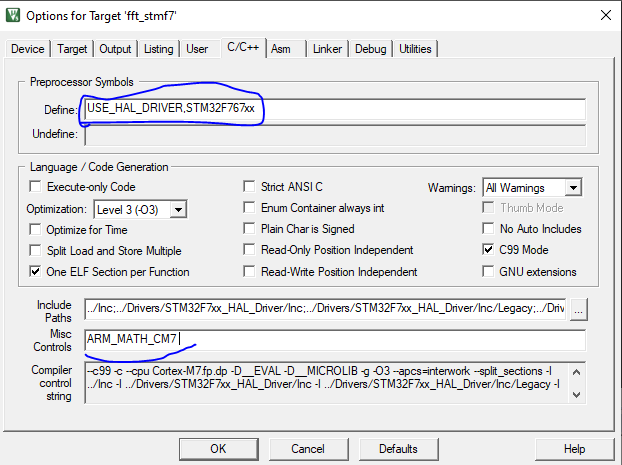

2020-08-27 2:51 PM
Thank you Clive or your response
I am a little bit confused however
I am guessing I didn't specify it in a correct place.
where exactly do I need to write that down?
Do I need to add something to the blue circle related to CMSIS or do I leave it as it is
again, thanks for your response

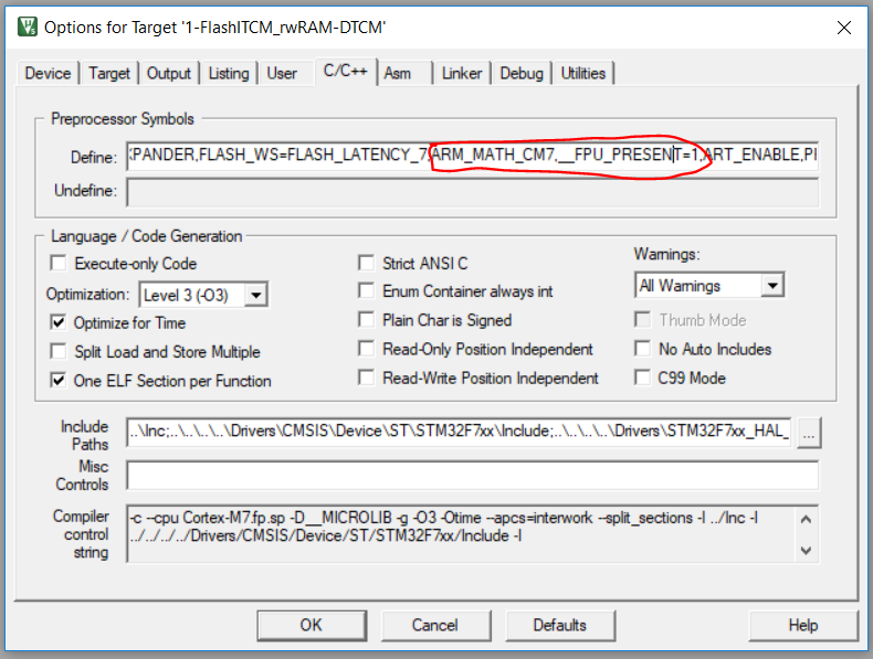

2020-09-09 4:34 AM
Hi @hashtala ,
If you didn't yet found the answer to your question: the new defines need to appear in "Preprocessor Symbols" section.
Look to the configuration used in the project STM32CubeExpansion_AN4667_F7_V4.0.0\Projects\STM32F769I_EVAL\stm32f7_performances for example:
This example with some other ones are available in the package X-CUBE-32F7PERF.
-Amel
