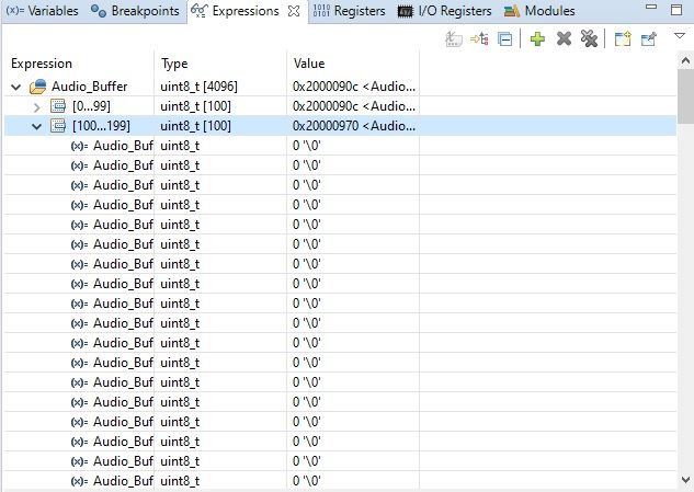

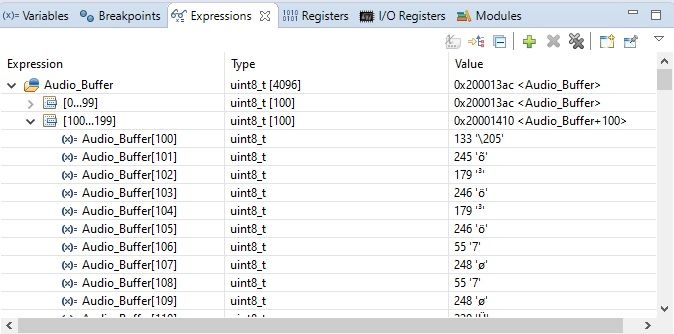

Audio_playback_and_record inside audio buffer data;
And my own project inside audio buffer data;
As you can see there is always '/0' except 0-99 indexes(that's include audio format data like wave, riff.)
