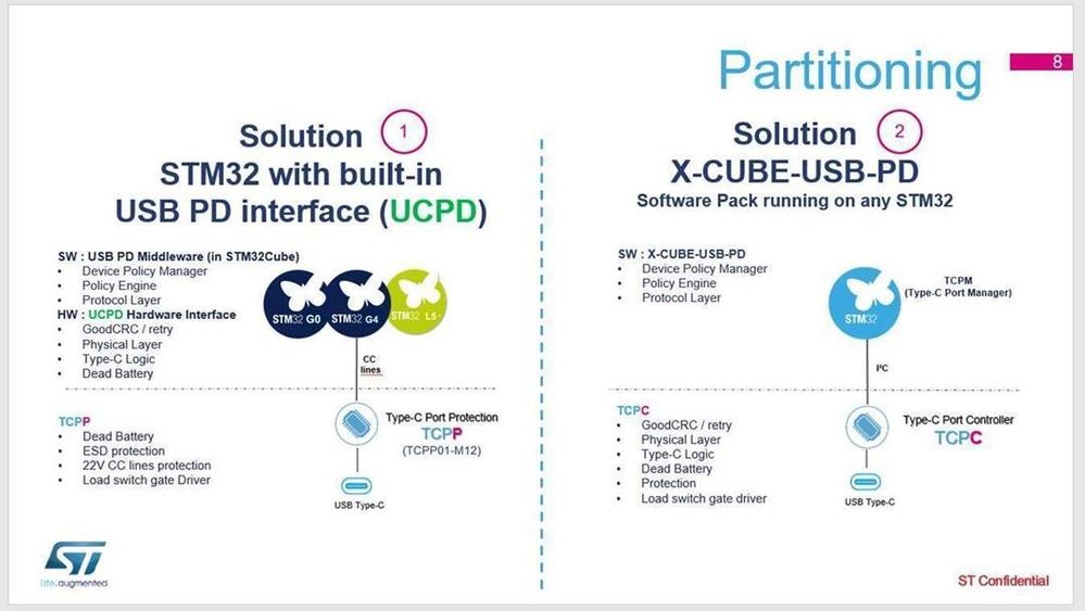

We did not deliver VCONN applications on X-CUBE AFE solution. This solution is no more supported for P-NUCLEO-USB001.
In addition to this solution, we have introduced traditional STM32 MCUs with native hardware interface (called UCPD) to support USB-C and Power Delivery Technology.
This solution �?� described below, is available in STM32G0, STM32G4 and STM32L5 product families.
It comes with a complete ecosystem (such as a discovery kit and a debugging tool) that simplifies UCPD configuration and use.
USB PD middleware stack is now part of STM32Cube (so X-CUBE-USB-PD expansion pack is not needed anymore when this solution is selected)
To make this new solution even more attractive a companion Type-C Port Protection (TCPP01-M12) is available to protect the CC lines against ESD and short to VBus.
Further information on that new offer are available here after.
