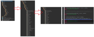

2025-02-03 9:04 PM
I am getting the above error in the code. Don't know why it is happening? @STea
2025-02-04 2:32 AM
Hello @vbk22398 ,
You need to add the have
#define HTTPD_USE_CUSTOM_FSDATA 0
in lwipopts.h.
Regards
2025-02-04 4:28 AM
Tried this already. Still the issue persists.
Thank You!
@STea

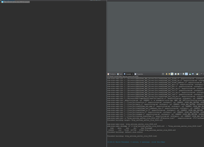

2025-02-04 6:53 AM
Hello @vbk22398 ,
I'm compiling the same project I've shared with you on GitHub, and it is working fine and I have even got it from GitHub again using git clone command:
git clone https://github.com/stm32-hotspot/CKB-STM32-HTTP-Example-With-LWIP-Debug.git
and recompile it and it is compiling with 0 errors please try to get a fresh project and recompile with a new version of Cubeide I've tested on CubeIDE V1.16 and 1.17 and it is working fine
