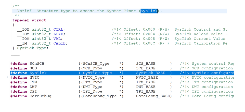

When I chased up the `Systick` define in `core_cm4.h' I find that `SysTick` is defined as I expected, snippets below,
What am I missing here?
2025-02-11 5:03 AM
What are you intending here:
SysTick->LOAD(SYSTICK_LOAD_VAL);That doesn't make sense?
You've written as if LOAD is function/macro call, but LOAD is just the name of a register
Did you mean
SysTick->LOAD = SYSTICK_LOAD_VAL;

2025-02-11 5:05 AM
Aaahhh yes, I'm on auto-pilot & just couldn't see it, thanks
