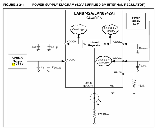

Checking the board schematic of ethernet section, it looks fine for LAN8724 VDDIO=VDD=1.8V and 3.3V to transformer section.
Using this eval board for 1.8V environment project, enthusiastic hope to make it works stable.

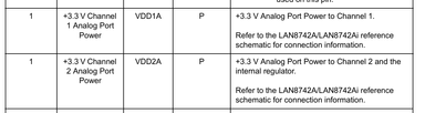

No.
The LAN8724 chip needs 3.3 V on VDD1A and VDD2A. It is not guaranteed to work if these are 1.8 V. Since the boards connects these pins to VDD, it won't work when VDD is only 1.8 V.
