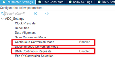

2024-04-04 7:13 AM
I've created a project based on STM32F407-DISCO board on which the ADC is triggered by TIM1-CC1 event. DMA has been used in circular mode to transfer the converted data to the memory.
The converted channel is the internal Temperature sensor.
Hope it helps.

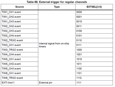

Thank you for your replies. I did a check on the ADC_CR2 bits by reading them. I found the value after all the initializations, to be 0x400. Just the EOCS bit is set. So I did a brute force setting of the EXTEN bits by
ADC1->CR2 |= 0x30000000; How to set these bits through the HAL call?
After this to start one set of conversions I called -> HAL_ADC_Start_DMA (&hadc1, (uint32_t *)adc_buf,ADC_BUF_LEN); This seems to convert. TIM1_CH1 event value is 0000 so left it as it is. Sharing the project is no issue but the entire code is in a mess. I have several unused functions etc. I am posting the ADC init code. Here is the timer code

2024-04-04 7:13 AM
Hope it helps.
2024-04-04 8:42 AM
Hi SofLit,
Thank you very much for sharing the code. I will go through it and revert if I have any questions.
2024-04-04 8:44 AM
