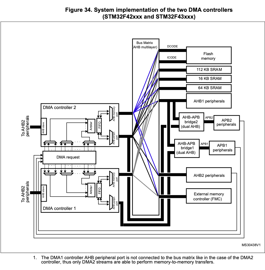

To try to close the loop on this thread: I eventually discovered that the reason the above code doesn't quite work is because the DMA controller that tim4 uses isn't connected to the peripheral bus on which SPI1 resides. As such can't "talk" to each other on an f4, which is specific to that MCU family. I hadn't really bothered to deeply internalize this (because I've not yet experimented with having one peripheral talk to another).
Switching to use a timer with a DMA controller that CAN talk to AHB1 (which is where spi1 lives) allows the code above to work fine. In my case, this could be either timer1 or timer8.
All in all, a very neat trick that I'm glad to have learned!
