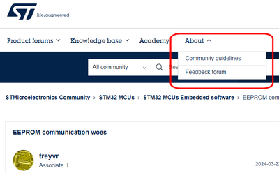

There's a Feedback Forum for feedback on the forum itself:
