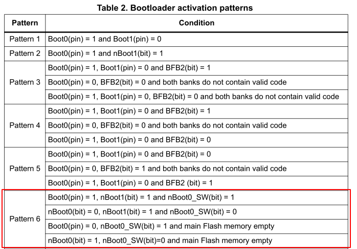

and on Page 24, Bootloader activation patterns, where can I find nBoot0_SW and how to set it?

Your chip doesn't have an nBoot0_SW bit. You cannot set it because it doesn't exist. Pattern 6 is not a relevant bootloader pattern for your chip.
On chips that have it, nBoot0_SW (aka BOOT_SEL) is within the option bytes and settable just like nBOOT1. The STM32F042 has this bit.

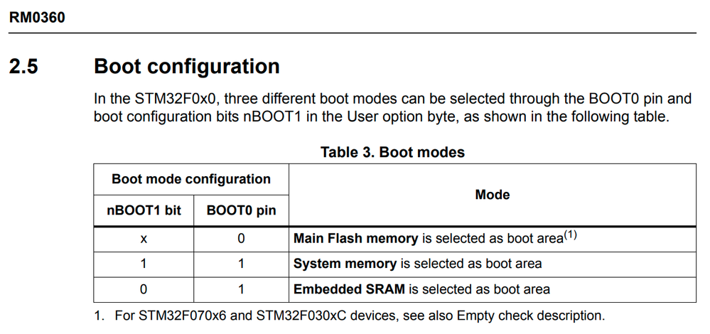

nBOOTx are option bytes and can be set using STM32CubeProgrammer or in your code, if they exist on your chip.
Look at the reference manual for your MCU. Only the nBOOT1 option byte exists, so you will also need the BOOT0 pin high to activate the bootloader.

nBoot0_SW(bit) = 1, I don't quite understand, what is it and how to set it?

I am confused by the description below on AN2606 "STM32 microcontroller system memory boot mode"
"The STM32F070x6 bootloader is activated by applying Pattern 6 (described in Table 2: Bootloader activation patterns)."
I understand the confusion now. The manual should not say Pattern 6 in particular. It should say the bootloader can be activated by applying ANY of the (available) patterns from Table 2. In this instance, patterns 1 and 2 are relevant.
