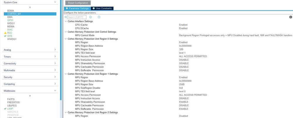

}Unfortunately, I'm still new to ethernet communications so I'm not entirely sure what the issue is. I suspect the issue has to do with some of the Cortex settings that were modified as described in the above link:
My guess is it's trying to write/set something up in a place it shouldn't and that's the reason for the error? To be fair though, I don't understand what the error is trying to tell me other than it's trying to setup something related to the UDP and is just hanging. Maybe the issue is elsewhere.
Unfortunately, I've been poking at it for a few hours, managed to narrow it down to where it is, try a couple different configurations (both with and without OS, so it doesn't appear to be specific to that) and I end up in the same place. I must have a setting wrong somewhere.
At this point, I'm just trying to be able to simply ping the board so I'm hoping I get these basics down and can build on it from there. Any help you can give me would be greatly appreciated!
