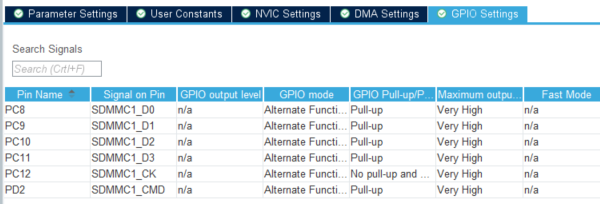

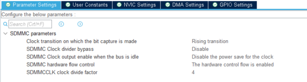

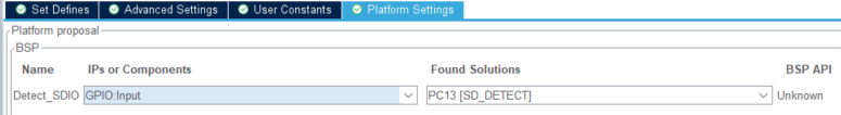

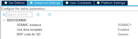

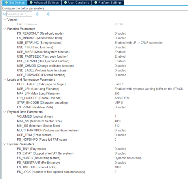

I'm actually trying to write on a µSD card with a STM32L486QGI6.
The function f_mount() returns FR_NOT_READY whether the µSD is placed or not...
I already checked dozens of tutorials and examples for CubeMX generation (Checked the pins, the SD_Detect in pull-down, Pull-Ups for the other pins except CK, global interrupts, Clock of 40MHz divided by 4, etc...)
There is my code and the CubeMX configurations :

hsd1.Instance = SDMMC1;
hsd1.Init.ClockEdge = SDMMC_CLOCK_EDGE_RISING;
hsd1.Init.ClockBypass = SDMMC_CLOCK_BYPASS_DISABLE;
hsd1.Init.ClockPowerSave = SDMMC_CLOCK_POWER_SAVE_DISABLE;
hsd1.Init.BusWide = SDMMC_BUS_WIDE_4B;
hsd1.Init.HardwareFlowControl = SDMMC_HARDWARE_FLOW_CONTROL_ENABLE;
hsd1.Init.ClockDiv = 4;

Check what the state of PC13 (SD_DETECT) actually IS
Typically the sockets have this as a switch to ground, with a pull-up, so it reads high when no card is present,and low when there is.
Write that code, and have it check it prior to trying to mount. Perhaps instrument the DISKIO level routines to see where it checks and reports if it's ready or not, and that the card has actually been initialized.
Check where its physically calling the HAL_SD_Init() function, and the MSP routines below it. If the interface/peripheral is not up, none of this will work.
