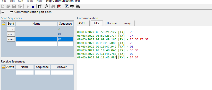

0693W00000KblTiQAJ.pngI correct myself.
only now, after many attempts. i got something on serial. (using docklight)
