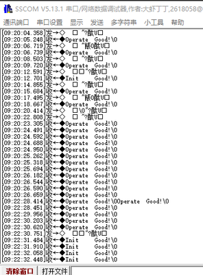

Hello, I am using STM32C071 in my project, the main work is to receive data from PC, then do some controls, then send data to PC.
However, during the send data to PC step, sometimes the data will be sent continuously, it doesn't meet my requirements, sometimes it working well, this is very unusual. please provide some advise.
After I send the data and proceduce the 'handleRecvData()' func, the data I received from PC is not un-stoppable.
I have checked several days and I can't find what caused this ab-normal.

Hi, @MOBEJ
I checked the demo example, and checked my code, the read thread and write thread can work very well respectively. My point is, when I use Mutex or Semaphore to make the parameter "resultCode" change in two thread, the write thread working ab-normal.
or could you demo the mutex or semaphore 's usage for two thread, thank you very much.
