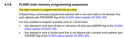

2025-11-16 8:33 PM
The STM32C0 reference manual section 3.3.6"The programming operation consists in writing ‘0’ to some bits of a previously erased double word (64 bits). The programming operation can only be performed on double words which have been previously erased. It is not possible to program a second time a double word without erasing it first."
The STM32C0 reference manual explicitly states that a double word can only be programmed once after an erase.
Any attempt to reprogram (even just 1→0) will result in a programming error.
