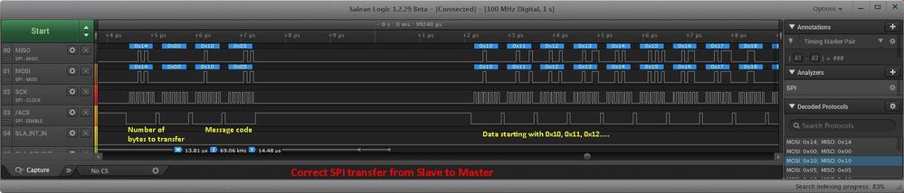

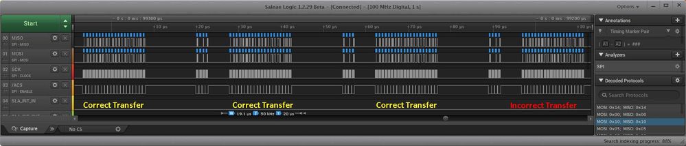

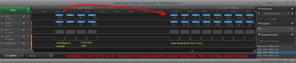

At times, I'm seeing the first byte of the 4-byte transfer duplicated in the data transfer - thus shifting the bytes by one, and adding one byte to the transfer. This may make more sense by looking at the captures from the logic analyzer. I am using HAL_SPI_Transmit_IT to the master, and HAL_SPI_Receive_IT on the master side to receive the bytes.

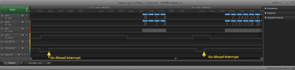

This is a failed transfer go-ahead interrupt showing. The idea behind that interrupt was to prevent the master from starting the transfer before the slave is ready. The go-ahead (rising edge) interrupt goes out, then /ACS goes active, then the clocks start.
This image has one more change - I reset the SPI between the first transfer and the second. Now instead of getting the extra 0x14, I get an extra 0x00. Resetting the SPI would make sure that there is nothing in the TX buffer. I also removed the SPI_NSS_PULSE_DISABLE from the Slave TX Side which is why all of the clock pulses are now together.
BTW: I forgot to mention in the original post that I am making sure that the TXE is set and the fifo is empty. I check this before starting the first transmit and before the second transmit. Now I check it before the second transmit and before the reset.
