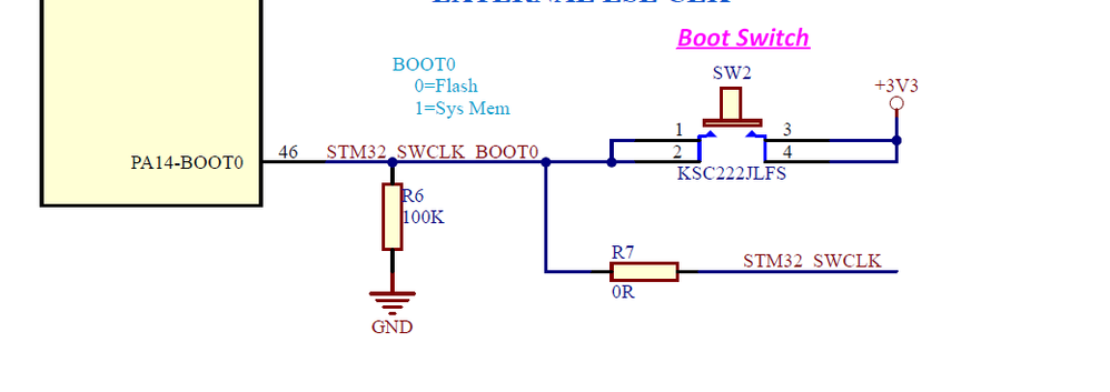

I done flash erase, then the USB is detected in my PC as "DFU in FS mode" and i can able to program it. I hope this is expected behavior. But i do see issue only after flashing my application code, I can't get into a bootloader mode.
I tied BOOT0 to VDD and then power on the device, even in this case, USB DFU is not detected in my PC. I expected with BOOT0 to HIGH,makes the device into bootloader mode.
Do you have idea why it is not entering into a bootloader mode?

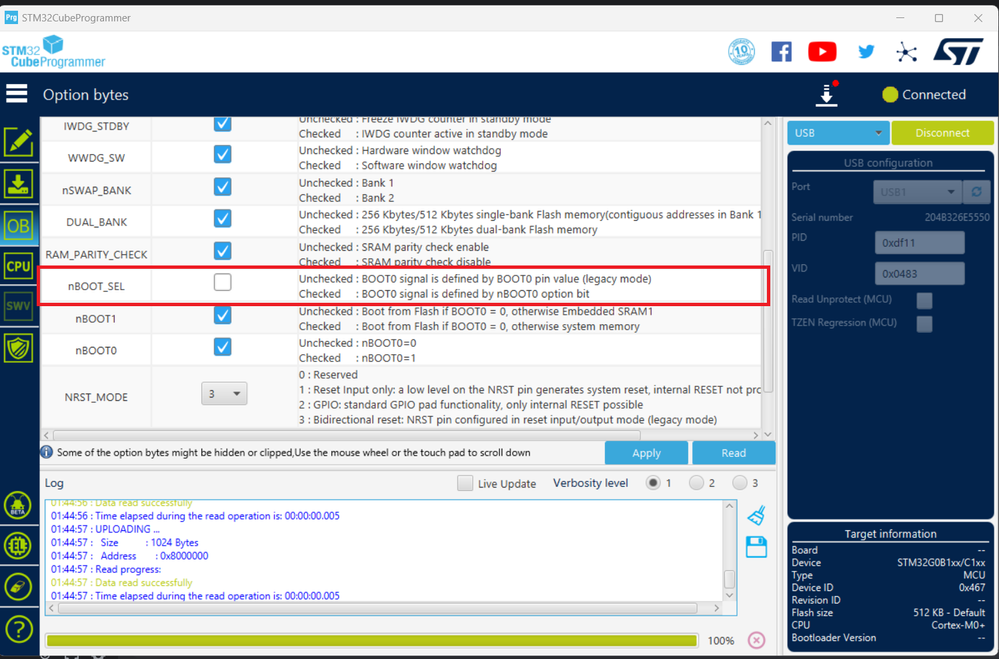

2023-06-02 1:41 PM - edited 2023-11-20 4:16 AM
Hi @uwe Bonnes ,
Configuring Flash option bytes "nBOOT_SEL (bit) to 0" resolved my issue.
This configuration decides the bootloader mode based on Boot0 pin value.
So, pressing the Boot switch and then triggering the Reset switch, puts the device now in bootloader mode.
2023-06-02 1:41 PM
