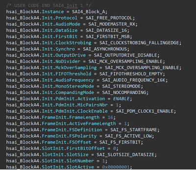

Does anyone know what may be causing this? I'll drop my CubeMX configuration, in case it is useful:

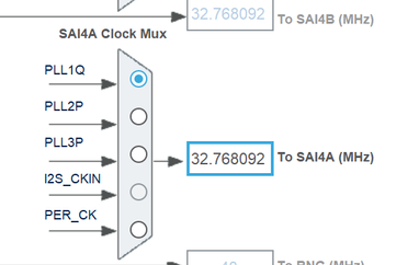

I found a way to mux ~32.768 MHz (i.e. 16,000 * 2048) to the SAI4. With master clock division and oversampling disabled, I still get all zeroes. This is 16 bits per sample. If I probe the clock pin, I see 128kHz, which doesn't feel right either.
Thank you for the reply, I'll keep chipping away at this. The clock is a new lead. I'm just so lost on how to configure it properly (it looks like a lot of registers and formulas)

I did eventually find the solution. To my original problem: I forgot to enable the active slot. It was that simple. Just go to CubeMX > SAI4 > Configuration > Active Slot and enable one or all of them.

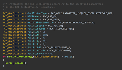

To the zeroes problem: It was the peripheral clocks. I found this answer by JW which gave me an idea of what clock frequency I should aim for. From there I just messed around with the clock dividers until I got something very close, and now am getting a proper signal on PE2. Notably, it seems like there's something weird about the way the HAL calculates MCKDIV, so I just set the audio frequency to the one that's dependent on MCKDIV and the kernel clock and just calculated it myself with some help from the aforementioned post.
