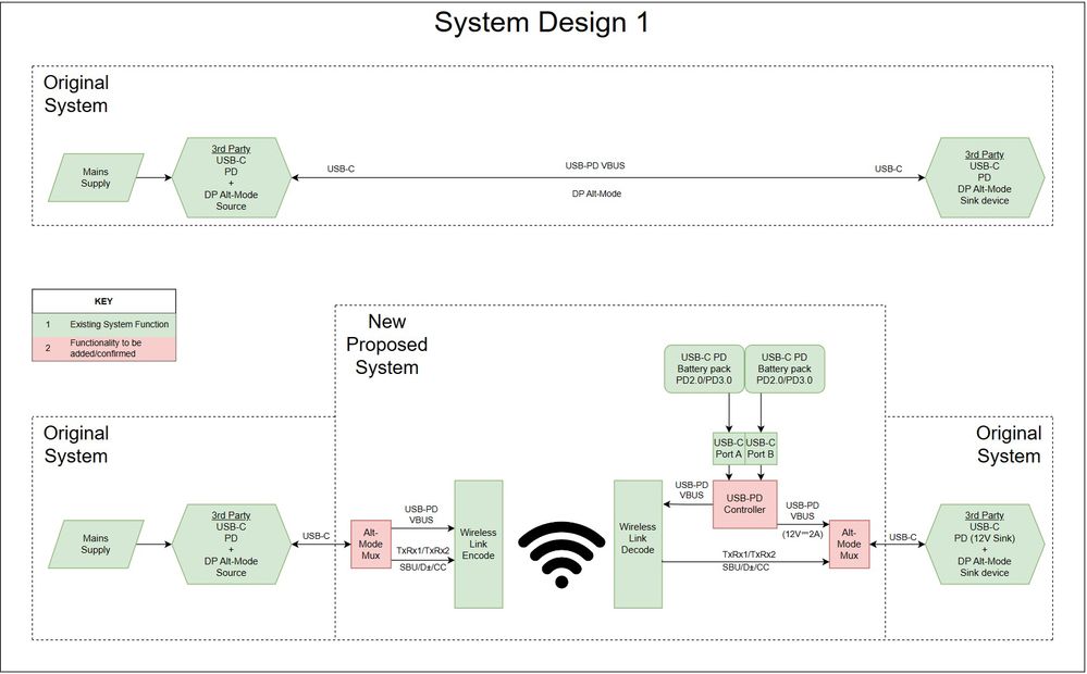

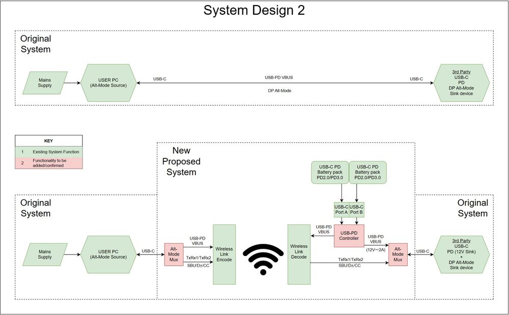

I'm drafting a "Wireless USB-C Displayport Alt-Mode System" that is primarily intended for detethering 3rd-party USB-C DP Alt-Mode devices.
There are two distinct system scenarios, though I am mainly concerned with System Design 2 using a PC as the source device (Simpler starting point):
*Note:
As I understand it, we want to pass all USB-C DP Alt-Mode signals from the Source Device to the Sink Device, as we essentially want to be invisible to the original interface.
Questions:
- What solutions can ST provide to overcome this?
- Will System Design 1/2 theoretically work? And if not, why not?
