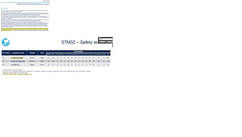

We are selected Trustzone MCU STM32U585ZIT6Q for our product we have some queries regarding the certification
Based on the attached user guide snapshot, we could understand this U5 series chip have a Class B library that supports IEC 61518 and was adopted to fulfil the IEC60730 requirement.
Is that ok to proceed with UL1998/IEC60730 certification by integrating the ClassB STL library for the U5 series?
Also, could you share the latest UL-compliant certificate for the STM32 U5 series?
Thanks
