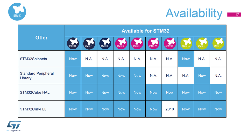

I found in a PDF document called ''STM32 Embedded Software'' following table where just ''2018'' is stated.
Could ST give us please a more exact release date of the STM32H7 LL API (2018 Q2/Q3/Q4)?Thank you in advance.Solved! Go to Solution.

Finally I got an answer from ST:
Dear customer,
LL API for the STM32H7 will be probably available in Q3/2018 (probably September 2018).
Best regards,
ST MCU Support Team
