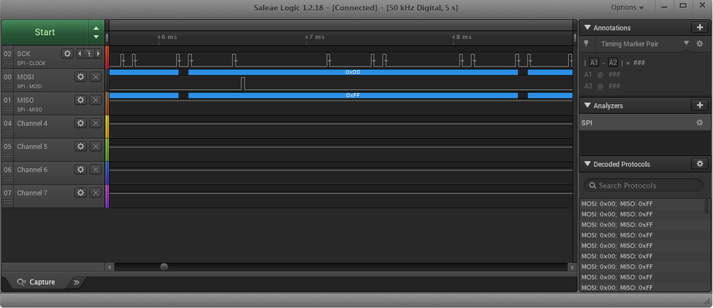

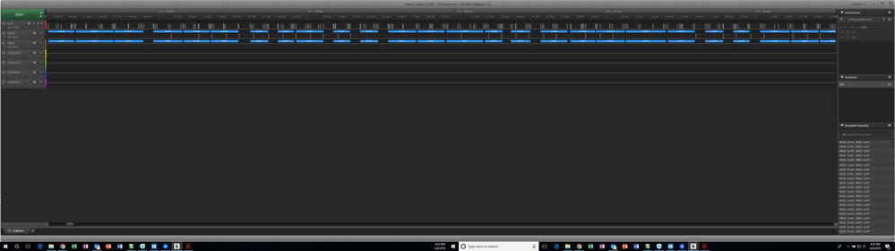

My logic analyzer output is below. My clock is irregular and MOSI has garbage data. Anybody with any leads, please do let me know. Thanks in advance for your valuable time.

Inadequate LA sampling rate? Grounding problems? Inadequate pin speed setting or overloaded pin?
The picture is illegible. Please make a smaller screenshot, or zip it up and insert as attachment.

Not sure what I'm supposed to see in the screen shot, show one sequence that describes the behaviour you want to show.

2018-06-11 8:49 AM
Hello Jan,
Thank you so much for your valuable time on my question. Screenshot attached below for further inputs. Working on your other questions.

2018-06-11 8:56 AM
Hello Jan,
Thank you so much for your valuable time on my question. The issue with the behavior of the clock and MOSI pin(their irregularities) is the sequence i wanted to show. Working on your other questions to check the respective pins.

I'd suggest slowing your SPI clock and increasing the Saleae sample rate to the point you have a 4x ratio. That should clean up the display.

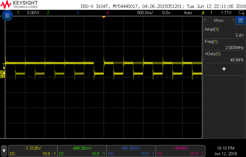

2018-06-11 1:57 PM
Hello Jan,
I tried to use a keysight infivisionx MSOenabled 3104T Oscilloscope for viewing the clock frequency. It is not the expected one. It shows a constant frequency (of 2MHz), although varying the input parameters( Like Baud Rate,etc.,). If you got some leads, let me know. Thanks for your time again.
Muthaiah Murugappan
2018-06-11 1:59 PM
Hello David,
Thank you for the suggestion, but my Saleae hardware doesn't support larger sample rate. I guess, 4x ratio might be difficult with this piece of hardware. Working with slowing down the SPI clock, let me know if you have any leads on this.
Thanks
Muthaiah Murugappan
2018-06-11 2:17 PM
If I'm reading the displays you've posted correctly it's configured for a 50 kHz sample rate. If you reduce the number of active channels to only the SPI signals you need you should be able to configure it for a much higher sample rate. (My old Logic 16 is currently configured for 7 channels @ up to 40 MHz.)
