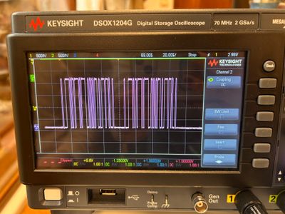

Are you sure the message are not physically duplicated on the bus? did you check that with a CAN analyzer or an oscilloscope?
2025-09-04 7:40 AM
Hi @mƎALLEm ! Thank you for your quick response.
I checked and the message is sent twice indeed.
The slave is a STM32H563VIT6. In the code the message is only sent once.
